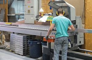

“Our batches can have a few pieces up to hundreds to process,” said Anne-Marie Ayotte, company manager. “We used to measure our profiles with a tape, use a metal angle and vise grip to secure the profiles, cut the material, then measure the length again. All this took time.
“In 2006 we added our first automatic measuring system to reduce our cutting time. Since then we’ve added two more to our equipment. We punch in the dimensions and the quantities on the keypad and begin the cut process. All measurements are stored in the system so if we have a repeat, we just ask for the program and the measurement system moves to its new position. We’ve increased our cutoff production by about 40 percent.”
Maximize the Money-Maker Spot
Dominick Olavarria, marketing and communication specialist at TigerStop, described how a basic automated measurement system can contribute to fenestration production: “A basic positioner can be adapted to almost any saw or cutoff device. Operators don’t need to set and reset manual stops, use tape measures, or mark the material before sawing, so accuracy is increased as well as speed. Depending on the weight of the material—the TigerStop will push up to 120 lbs.—the material can be positioned at speeds up to 180 FPM with an accuracy of ±0.004 in.
“Operator time is also saved when a system’s keypad is located near the sawing operation. Instead of having to go down and manually set the stop and slide the material against it, he just keys in the numbers and the positioner moves along the rail, pushing the material into place for an accurate cut. The operator doesn’t have to leave the money-maker spot, which is right where the saw is. A label can also be produced at the time of each cut so the operator doesn’t have to mark each piece.”
