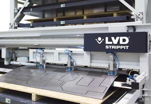

Pick-and-Place Options
"A robot that individually picks off parts allows you to automatically offload different size parts. And a big advantage is that the parts are neatly stacked without operator intervention and ready for the next operation," said McIntyre.
Vacuum cups and/or magnets can adorn a robotic arm that reaches into the punch press to grab an individual part as it is punched free from the sheet. The cups and magnets are programmed and activated for picking according to part geometry and nest location.
Magnets will pick any part configuration but are limited to ferrous stock and can magnetize the material. Attention also has to be given to the magnetic power to avoid picking more than one sheet of material when loading and latching on to the machine tool table when offloading.
Cups will pick parts from any material, but their use may be limited when offloading small or hole-intensive components.
If a part does not offer a large enough flat surface, or landing area, to accommodate the circumference of the cup, a secure seal for lifting may not occur. Creative programming, however, can provide a workaround. Kroll offered one option: "Some users will program a border around hole-intensive parts to create a landing area and tab the part to the border."
Parts that are too small to be individually picked by vacuum cups can be joined together to form a piece large enough for vacuum cup removal. "The programming software has the ability to make a mini-nest out of small parts," said Brady. "Say four, eight, or 10 parts are tabbed together, then the arm picks out the entire nest."
Various cup sizes can be mixed, matched, and interchanged on a robotic arm. Specialty cups can be added to the picking mix to handle challenging materials. For example, cups with a textured surface are designed to securely adhere to material with a textured surface, like tread plate, where creating a vacuum seal can be challenging.
Kroll pointed out two considerations when adding offloading automation: Work with flat material to ensure a good vacuum seal or secure magnetic hold, and be aware of material thickness. "We prefer not to use automation with material less than about 0.020 in. thick because the integrity of the material makes it difficult to work with the sensors that give you a reliable process."
