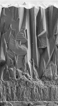

Textured Coatings
One of the newest technologies in aluminum oxide, CVD coatings is the process of texturing.
Engineers at Seco Tools are now able to control the crystal structure—the growth of the aluminum oxide coating —to generate a smoother surface.
“We are making a smoother surface to create less friction and grabbing and promote better chip flow,” said Graham. “The difference is created because the facet of the crystal is now parallel to the insert’s surface. We are trying to orient the crystal of the aluminum oxide layer in such a way to minimize friction.”
This engineering of the coating at the atomic level achieves three goals, according to Graham:
- Textured coating is about 15 percent tougher than a nontextured, traditional coating.
- The textured coating is 10 percent harder than a conventional coating.
- The texturing process produces a better insulating property.
“When all of the advantages are put together, we believe that the end result, on average, is about a 30 percent improvement in tool life,” said Graham. “These textured coatings also cover a broader application range. A job shop that cuts a variety of ferrous materials can find advantage using one of these products because it doesn’t have to inventory as many inserts.”
